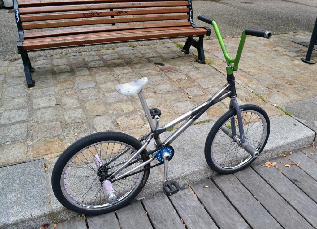

Voici le cadre pour Ben Bello, le gérant de Soul BMX magazine :
PiR custom street frame
TT = 21.5"
CS = 13.75" slammed
HA = 74.5°
SA = 71°
Standover = 8.5"
BB height = 11.8"
117 mm long headtube
Mid BB
Swaged & bullet tipped CS and SS
Integrated seat post clamp
Wishbone on CS
Removable brakemounts
0.19" thick laser cutted dropouts
14 mm axle slot
Front gusset on TT & DT
Weight : 2200 g

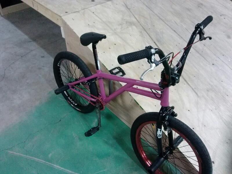

Cadre avec double top tube et fourche (pour KGB relfex) PiR :
Contact : pir.bmx@gmail.com
Flateu
Messages : 5403
Re: PiR products
Message par Flateu »
Han il est chouette.

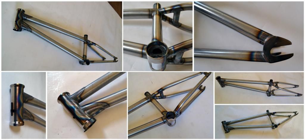

Mon cadre est enfin fini de soudé...
Voilà le résultat, pour le moment...
PiR custom flatland frame
X shape with a new design
TT = 19"
CS = 12.4" slammed
HA = 75°
SA = 72°
Standover = 4.53"
BB height = 12.6"
105 mm long headtube with PiR logo
Spanish BB with deeper machining for the bearing (to allow the compatibility with my new crank)
Additionnal star shape cut out and blind holes
Swaged & flatened CS and SS with extra bend on the drive side, to optimize the chain clearance
Integrated & hidden seat post clamp, totally different than the Strawberry one (you can't see the bolt)...
Special Wishbone (4 parts of tubes welded together) on CS & SS
Additionnal gussets on BB/downtube and TT/seat tube connections
Externally machined seat tube
0.19" thick laser cutted dropouts with integrated chain tensionner drive side
3/8" mm axle slot
Weight : 1680 g

PiR products a écrit :Mon cadre est enfin fini de soudé...
woOw, ça a l'air très bien !! :clap: :clap:

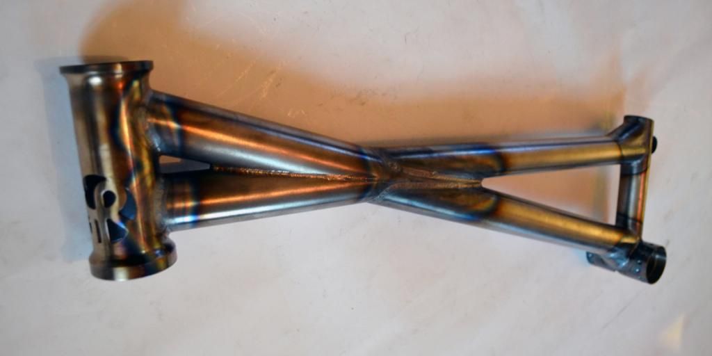

PiR products a écrit :X shape with a new design
PiR products a écrit :Integrated & hidden seat post clamp, totally different than the Strawberry one (you can't see the bolt)...
Pourrais tu apporter des précisions, descriptions, explications, photos sur ces deux points ?? :D

PiR products a écrit :Additionnal gussets on BB/downtube
et aussi sur ce 3ème point ? :D
car quand je regarde vite fait les 3 précédents cadres de flat que t'as mis en photo (excepté le Dividual Cold Embrace replica), il me semble que le down tube est positionné de manière semblable sur le bb, donc pourquoi ce gousset sur ton cadre ? c'est peut être refusé par tes clients

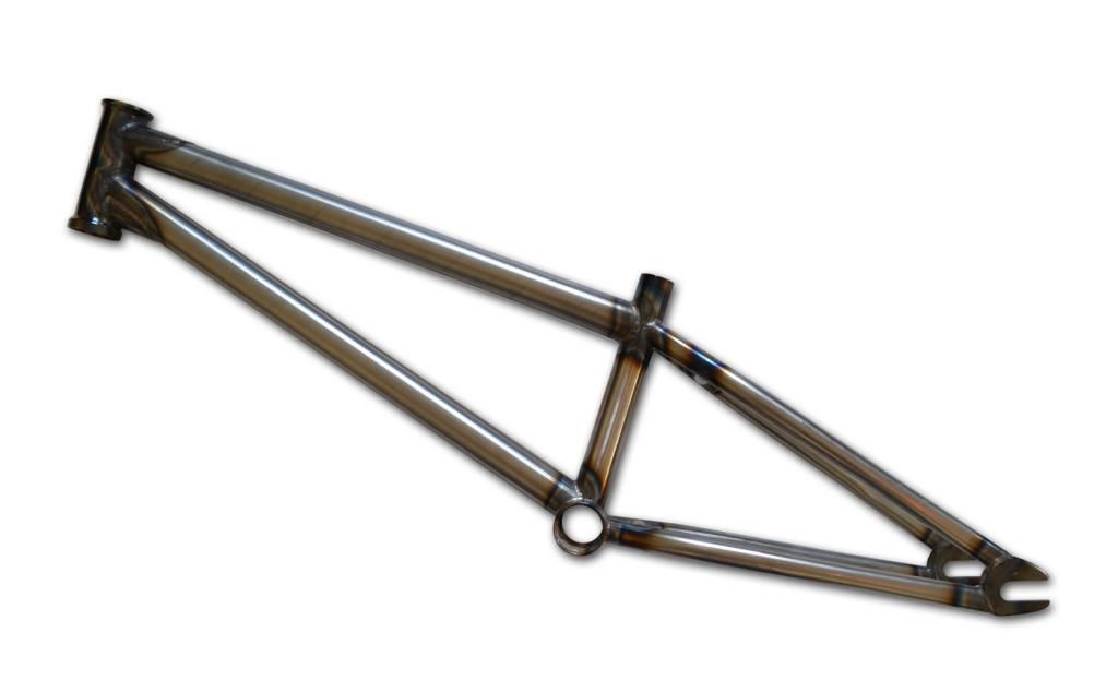

Nouveau cader de flat :
TT = 18.9"
CS = 12.375" slammed
HA = 75°
SA = 72°
Standover = 6.5"
BB height = 11.75"
114 mm long headtube with upside down cross cut out
Top & down tubes gussets
Spanish BB
0.25" custom dropouts
Weight : 1990 g

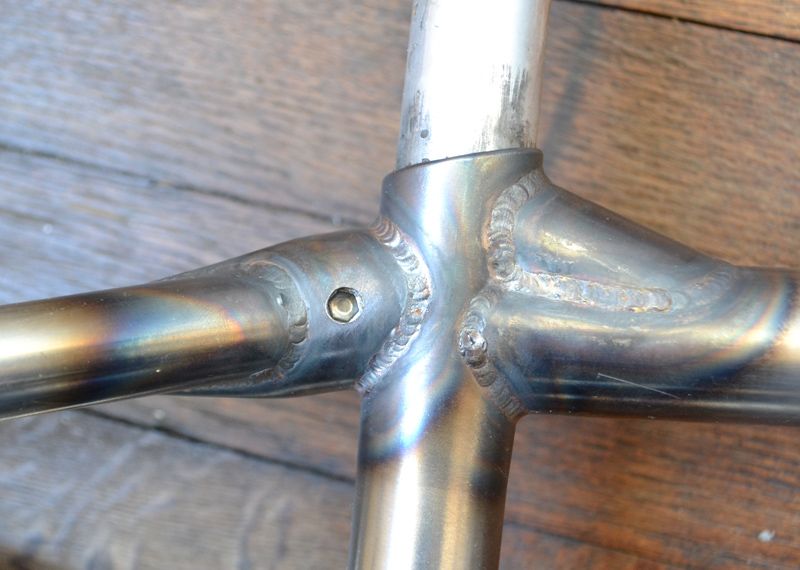

PiR products a écrit:Integrated & hidden seat post clamp, totally different than the Strawberry one (you can't see the bolt)...
Pour faire court, les 2 première parties des tubes sont soudés ensemble de la manière suivante (la pointe étant moins pointu dans la réalité). Ces 2 tubes sont plutôt épais, ce qui rend l'ensemble très rigide.
Pour ce qui est du serrage du tube de selle, voilà ce que ça donne de l'extérieur.
Je ne désire pas montrer ce système pour le moment, de peur de me faire copier...

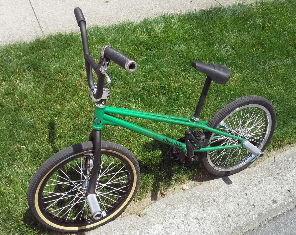

et sinon, t'as pas eu de photo de ce cadre Modernized Dividual Cold Embrace replica monté ? il est sex..
Je n'ai hélas que de très mauvaises photos...
Les couleurs ne sont même pas réalistes...
Voilà la vraie couleur du cadre, avec l'inscription "KOBURI" (nom du rider Japonais) en relief sur le renfort avant :

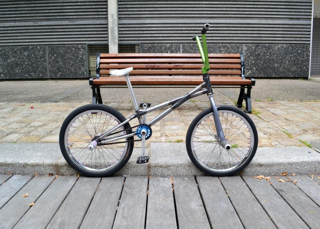

Voilà mon vélo avant peinture :
Messages : 2296
Localisation : nord-59
Re: PiR products
Message par Doug »
BOUMM!
:shock:
